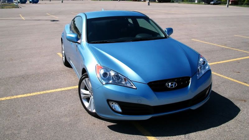

Found out driving home today that although my catch can on the PVC side is capable of withstanding the heat, it cannot handle the vaccum and the lid caved in. Oops :lol: Good thing I kept the original hose in the car just incase. Back to the drawing board :lol:

Still waiting in line to fix the hail damage with paintless dent repair. There were a lot of claims so they're pretty backed up for a while. Insurance said no to the replacement hood/trunklid.
When they fix the dents they'll be tinting it too, then it'll probably be snowing :lol:
