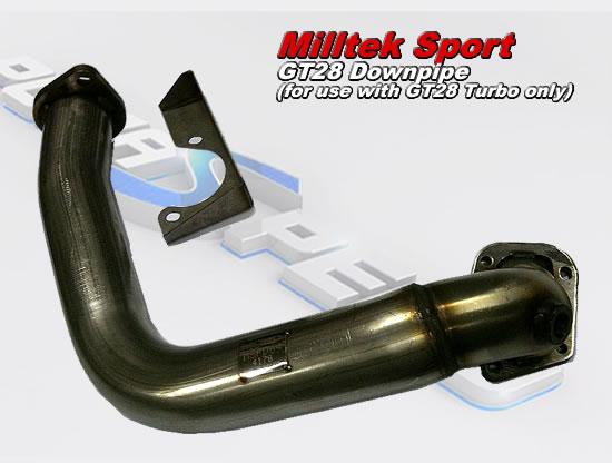

I am getting tossed back and forth between the SSC Design manifold with a Milltek decat pipe or the Top Speed street manifold.
Let me put into the plans I have. I want to run a GT2871R and I rather run the internal wastegate. Fitment if the SSC is perfect with the turbo and the decat to the zetec motor. The Top Speed one, I can't full say because I have seen most fit but the race one I used to have had to have some modifications done to it. (This is not a bash on TS)

The thing is the manifold and downpipe that you are comparing to our street manifold would run you $1400+ even before you import it into the USA. For $1288.95 you can go on our website and buy a street manifold configured for an MVS wastegate, our downpipe with the recirculate option, and even buy a TiAL MVS wastegate to go along with it.
And all those parts including the wastegate are made in the USA.
For both from pumaspeed would cost 903.33BSP shipped, that is 1312.18USD shipped. I really don't see the huge difference in price to really validate this.
