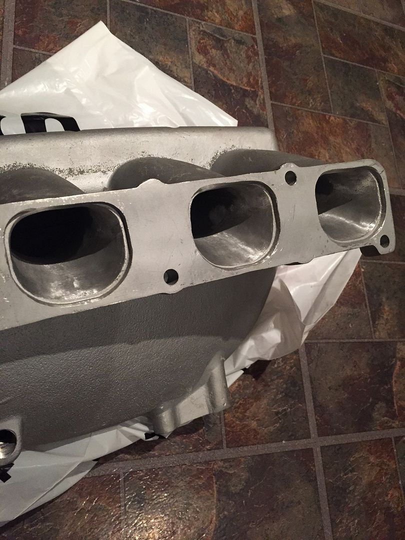

Hey man sorry ive been so busy trying to get the car done I haven't been paying much attention to the forum lately. The swap is done and together. Not running as of yet, having pats issues from going zetec-duratec.
I made a gasket out of gasket material, laid a bead of black silicone along the intake around the ports, and on the back side of the gasket to the head. Again, has not been tested, but there is no reason why it shoudn't work. I look at a mustang gt40 intake or a stock intake square ported, and there is minimal gasket material there. If the intake was passing fuel and coolant it would be slightly more worried.

So in that pic you posted, we are looking at a Cossie knock off, ported into the o-ring groove to match up to the
2.5 cylinder head intake ports.. right?
#25 · (Edited)
Yes correct. Maybe slightly larger than the port itself. Ever so slightly. When I put the intake on the head, you could actually see the outline of the bottom of the port. Saw this online as well. Someone posted a picture on a 2.0/2.3 that is, on a real cosworth. So out of the box it is slightly larger on the bottom and sides. So i made it slightly larger all around. What I did really was just remove the o ring groove, to make the port itself as large as possible, so it does not have to taper. Considering they are small to begin with.
