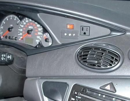

Looks good... I put in a 120 V power outlet that I tapped off the cig lighter outlet.

Directly behind the coin tray outlet... there's a small area behind the dash that had just enough room to fit the inverter.
One of these days I need to go back in and re-check my wires and connections, change out the one blown LED I burned out by accident and take some pics of the install.

You can crack the inverter open and gut its innards... that's what I did.
All you'll need to do is mount the bulk somewhere out of the way, like under the seat, and splice the wires from the unit to the outlet plug... then you can move that plug to where ever you want.
