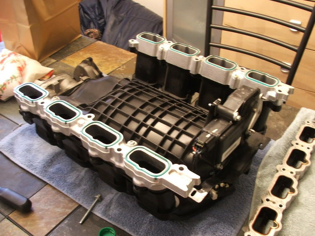

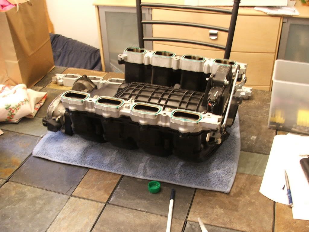

After a good deal of patience I finally got my CMCV Delete plates in.
From ding to dong the whole process took me an hour...Ya gotta love Mustangs for that...I think it took me twice as long to install just the cold air intake on my old Mazdaspeed Miata.....
Anyhow...this is what the underside of the intake looks like as I install the delete plates....

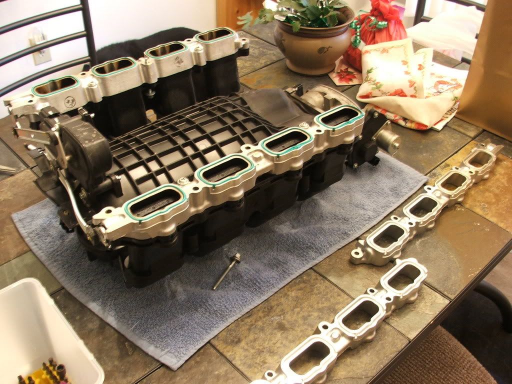

The delete plates themselves...perched on top of my new 'show' mats....Note the absense of anything in the holes....

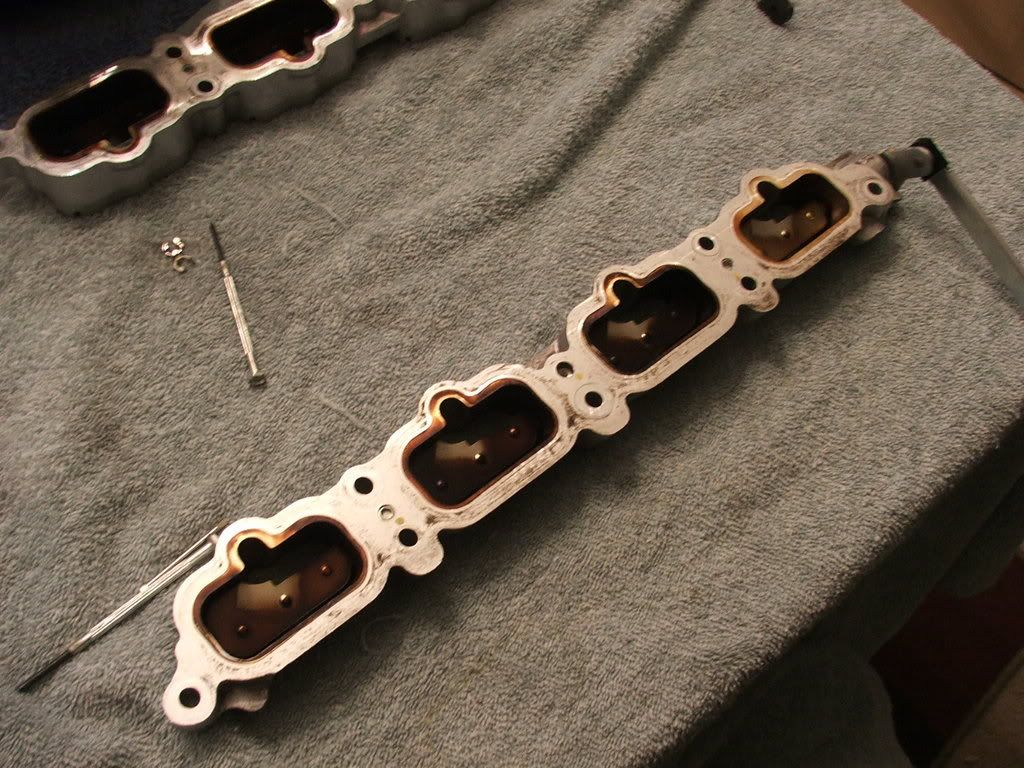

these are the OEM plates, note the partial butterfly valves....
The intake with the old and new plates added. You might also note the height of the intake itself, it's pretty tall, and the vee in the engine is deep....No wonder a Saleen blower installed there looks like it's not a supercharger at all, very stealthy, hehe....

Charge motion control valve, I assume?
What sort of gains are Mustang owners seeing from this? Duratec owners see hardly anything from removing the tumble flaps in their manifolds.
There is a pretty noticeable gain in throttle response. Power is said to be about 6-10 whp, but I can't substantiate that at this time.....
