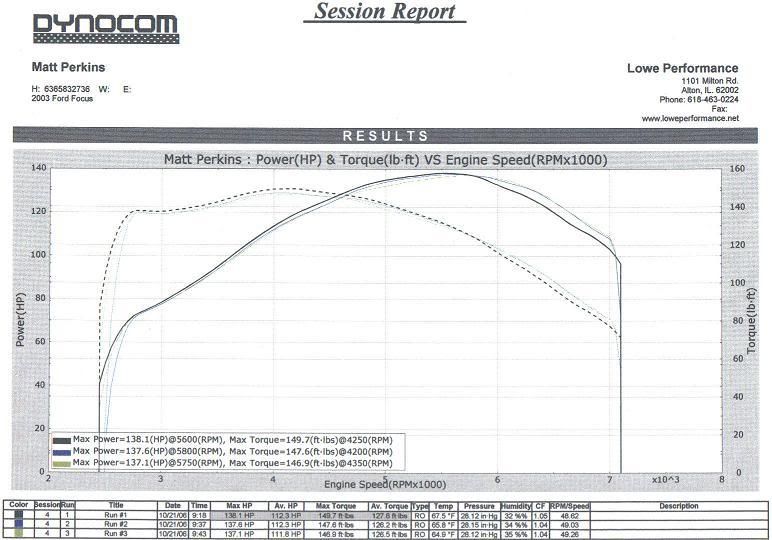

Hopefully Mr. Marcy can answer another question for me. A talk I had with a shop owner leads me to believe Walter may be specifically well-qualified for it.
I've always heard that, for instance, a Mustang dyno will read lower than a Dynojet dyno, and that Dynojet is generally the standard of measurement. How does a Dynocom weigh in?

Also, I don't think I've shown this off in Duratec Tuning yet, so here it is.
Smooth. :evilgrin:
FocusSportVP said:
^^^^ Well, lets see how the different levels of smoothing apply to this Dynocom then, if they have that feature. Please post up. :)
No idea. The shop only had it working for a few weeks. I was asking Walter about Dynocom earlier because the shop owner mentioned that he was involved with the company.
