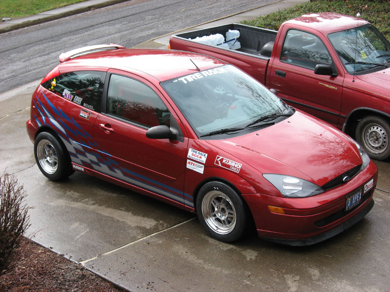

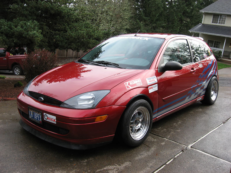

The wheels are Kodiak 15x8.5 three piece with 225/50-15 710s... makes maximum use of the 225.
Those future 275 Hoosiers should fit as well, and a wider outer wheel piece is always possible if need be.

Primaris said:
Awesome! Sweet wheels!

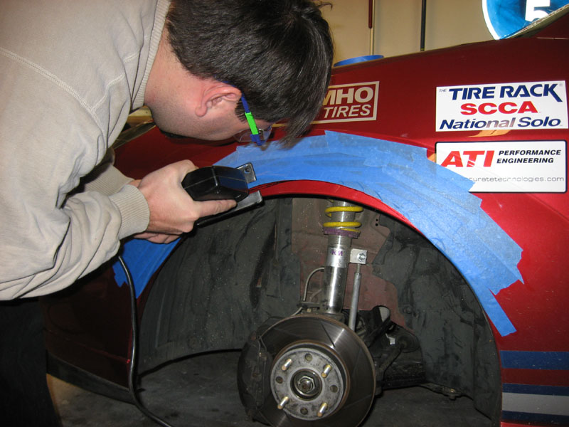

And now for the rapid fire questions...
How much do the wheels weigh? Why did you have to cut for the 225's? Offset? I thought the 275 Hoosiers were out?
They are 12lbs or so. We bought eight of them so we can experiment a little.
The 225s are monster-sized on an 8.5" wheel... like a full inch or more wider than they were on the 7"... so they need clearancing, especially when combined with a car that is really low.
The backspacing is pretty much identical to the 42mm offset Centerlines we were running, they just grew outward.
The Hoosiers aren't yet available for purchase, but we'll give them a shot when they arrive. They're a full .8" shorter, which could make things interesting.
It actually won't be left ugly. We're going to add a few non-functional pounds back on the body in the form of fender flares. Maybe we can make them functional if we call them "Urethane Cone Deflectors". ;)

carlfreddy said:
It's about freakin' time!
What does the clearance in the rear look like?
I'm assuming you're running a square wheel/tire setup or are you experimenting with some stagger?
Oh how I wish I could ever have a chance to pilot this beast.....
Rear inside clearance is a bit less than a fingerwidth... clearance to fender lip SHOULD be good... it just barely touched uncut, so the 1/2" I trimmed in the back should take care of it.
The are indeed square... no stagger at this point.
