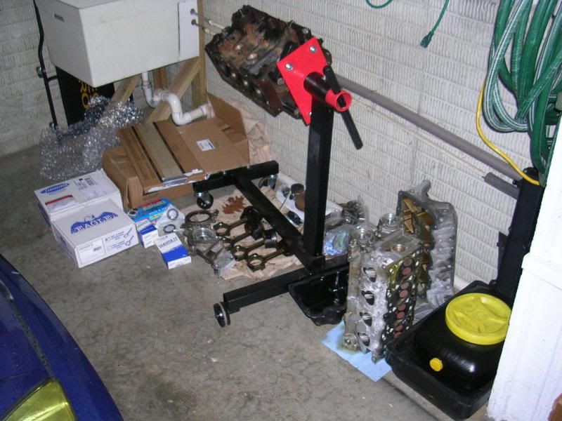

The "mess" in the corner. I still have a few stock parts laying around that I need to recycle or throw out.

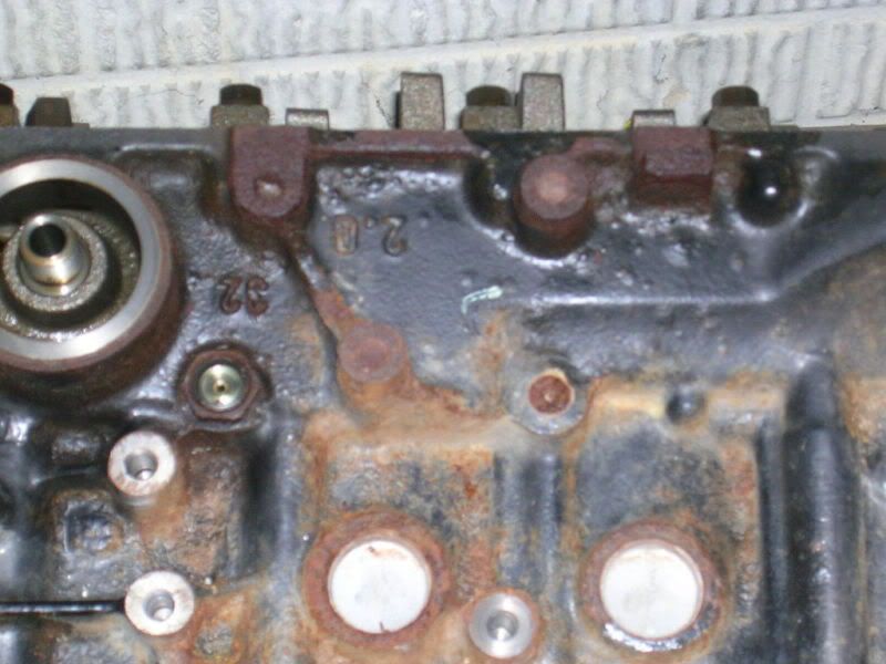

The block is a little rusty...

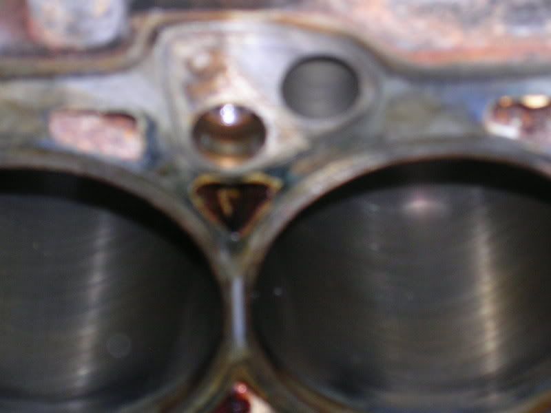

...but the cylinders look pretty good!:cool: I'm going to start looking around for a machine shop that can take care of getting the bearings and pistons clearanced correctly.

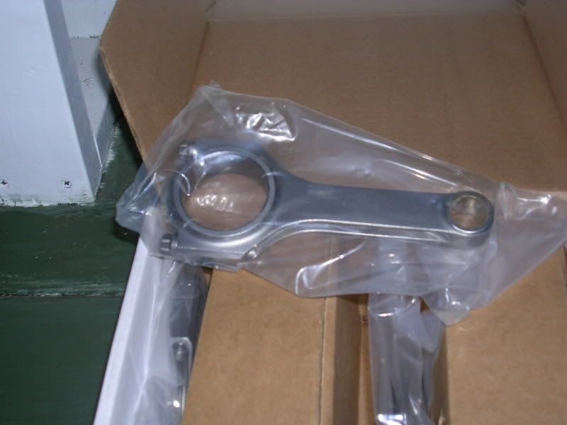

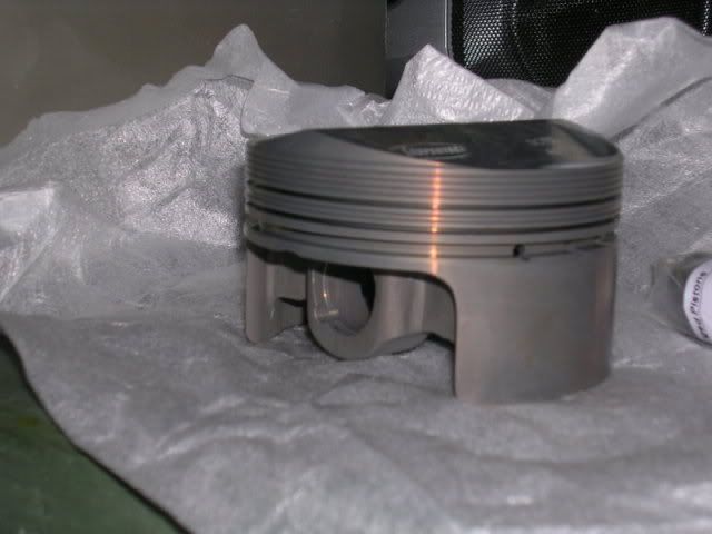

Enough of the old, rusty bits and pieces, how about some new shiny goodness!
Eagle Rods - the compromise between stronger rods and not breaking the bank.

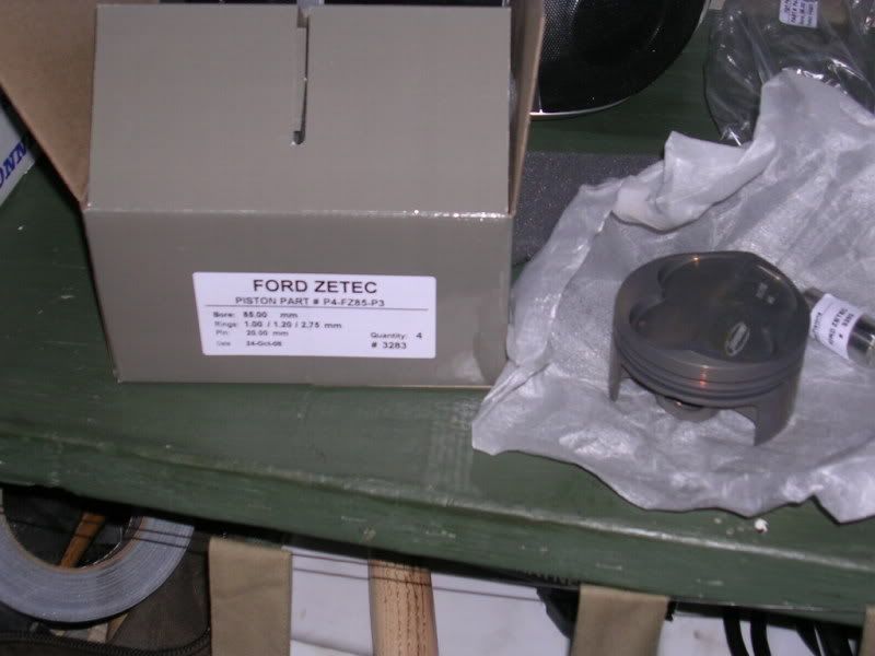

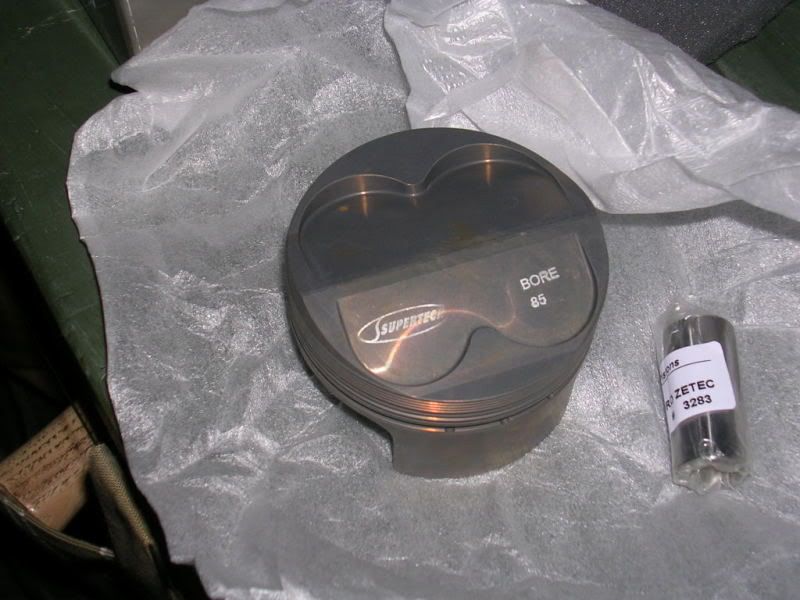

-Supertech 10.6 pistons

Your block doesn't look too bad on the outside. I built a block from a 00 DAILY driver with 220,000 (well seasoned) original miles. You can imagine how the outside looked, surprisingly the inside was perfect.

The other side looks a little worse, but the inside is immaculate. +1 for iron blocks.:p

which rings are you using? did you get the supertechs?
when you got the supertechs, did they come with specs for piston to cylinder wal clearances? if not contact supertech to find them out. all pistons have different clearance based on material, size and how the engine will be used. you don't want him to use general clearances.
