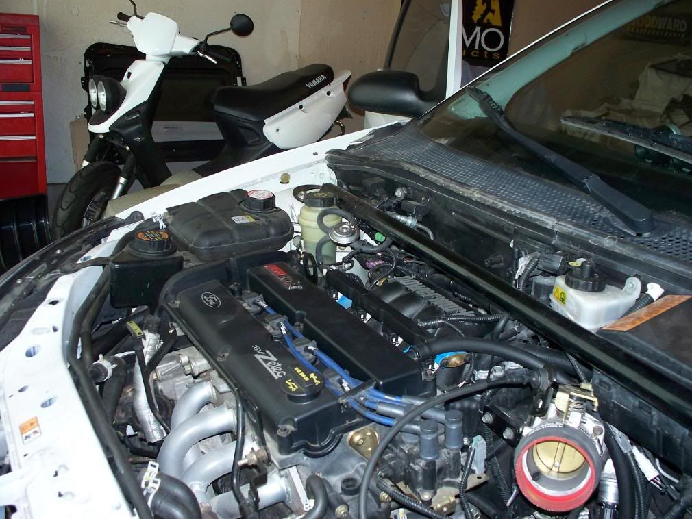

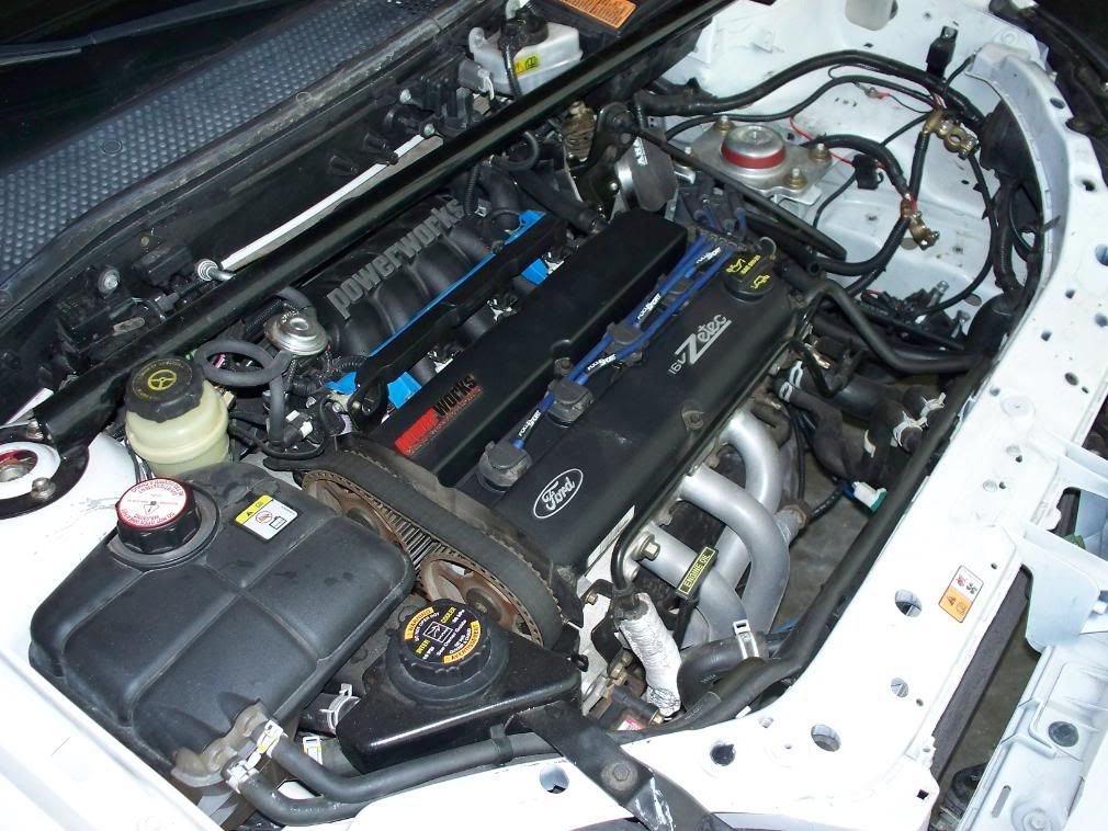

I've been working like crazy this winter out in the cold to get as much done as I could before the season starts. Here is my progress so far. The tubing for the rollcage is being ordered next week so that project is under way. It's not even close to finished but you'll get the idea from the pictures and captions.....
Some shots of where the project is at right now

Here is the custom front strut bar I made out of 1.25" stainless steel tubing and brackets. No bends, no flex! Very stiff :thumbup:

I pulled all the unnecessary wires/harness from the car that aren't needed anymore. This includes the radio, heater, AC, hatch release, power lock, speaker, power mirror, rear wiper, rear defrost etc. etc.. So if you're interested in what this mess looks like, here ya go
http://i244.photobucket.com/albums/gg26/xDangerx/Focus/100_0293.jpg
Some shots of whats left of the dash and my cleaned up wire job. The wires you see hanging down are for the custom toggle switches I'm putting in the dash to control the windows. This was a major PITA since I had to disect the quick connect harness that goes from the car into the door. As of now there are only 2 wires going from the door into the cabin... the yellow "up" wire and the white "down" wire to control the window. Everything else from that harness has been removed. The other wires that are laying on the pass. side floor are the harnesses for the Defi' gauges so those will be gone when the project is finished. Just a warning... if you're going to tackel this wire nightmare just be very patient and go SLOOOOOWWWW. Chase every wire from it's source to what it opperates, and then decide if it's necessary for the goal at hand.
