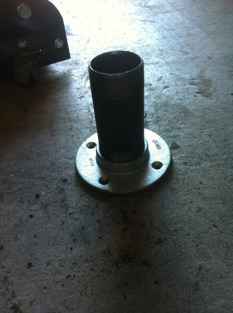

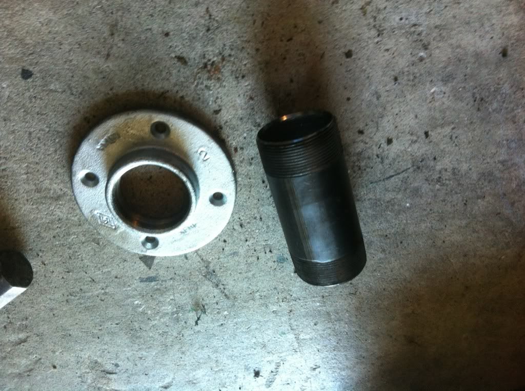

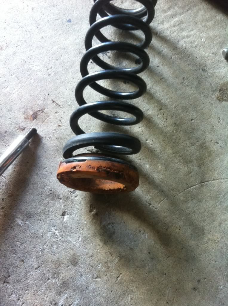

Bought these bad boys at Home Depot...2" (too big I didn't measure)

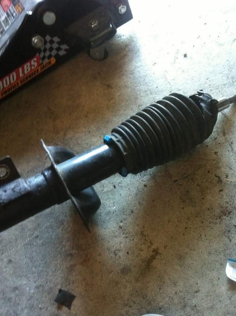

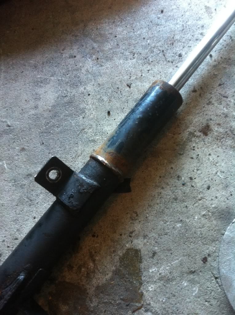

Then disassembled the strut
Grinded off perch

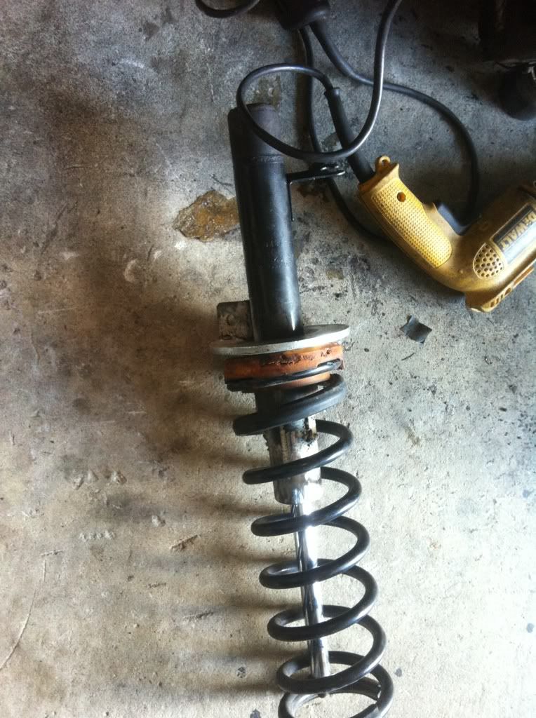

I've welded the new perch on and fitted on rear springs with those rubbers on both ends of the spring
Then I fitted it on the new perch and cut off the excess metal from the perch so the wheel can fit onto the hub without rubbing the new perch(about 1/2" of cutting).

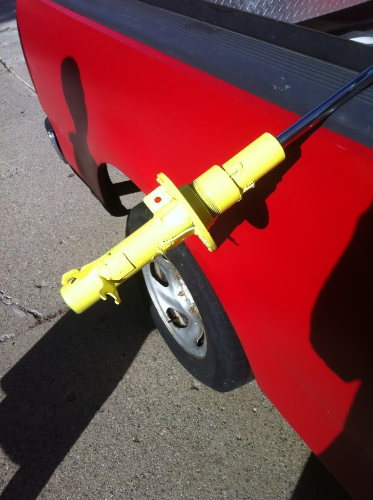

Painted the newly made strut
I then installed the spring and the top bearing fits perfectly into the foam thing from the rear springs.

Pics are up
I did cut 3 coils out of the rear springs I put on the strut.
I ended up setting the new perch as low as possible. And ended up welding it in place.
The bump stop is in the strut and I did not cut the shock tube and rethread it, didn't have time..
So now the car sits almost on the bump stop and bounces the car up really bad over a bump.
Few tweaks and it'll be fixed
It bounces really bad because you have OEM shocks that are now blown because they were never meant to handle being that low.
It only bounces really bad on a single bump, as if I jump the car. It doesn't bounce any other time.
But I understand the fact that they are oem and weren't made for this. It's just an experiment..

you put a rear spring on the front after you welded stuff from Home Depo onto a stock front strut? Then painted it yellow to make it look like a Koni?
