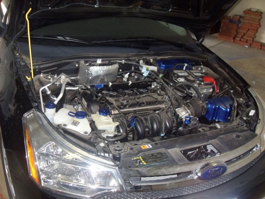

Painted Some under hood components

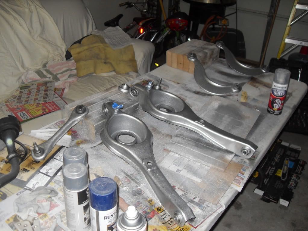

Painted the LCA, UCA and FLCA

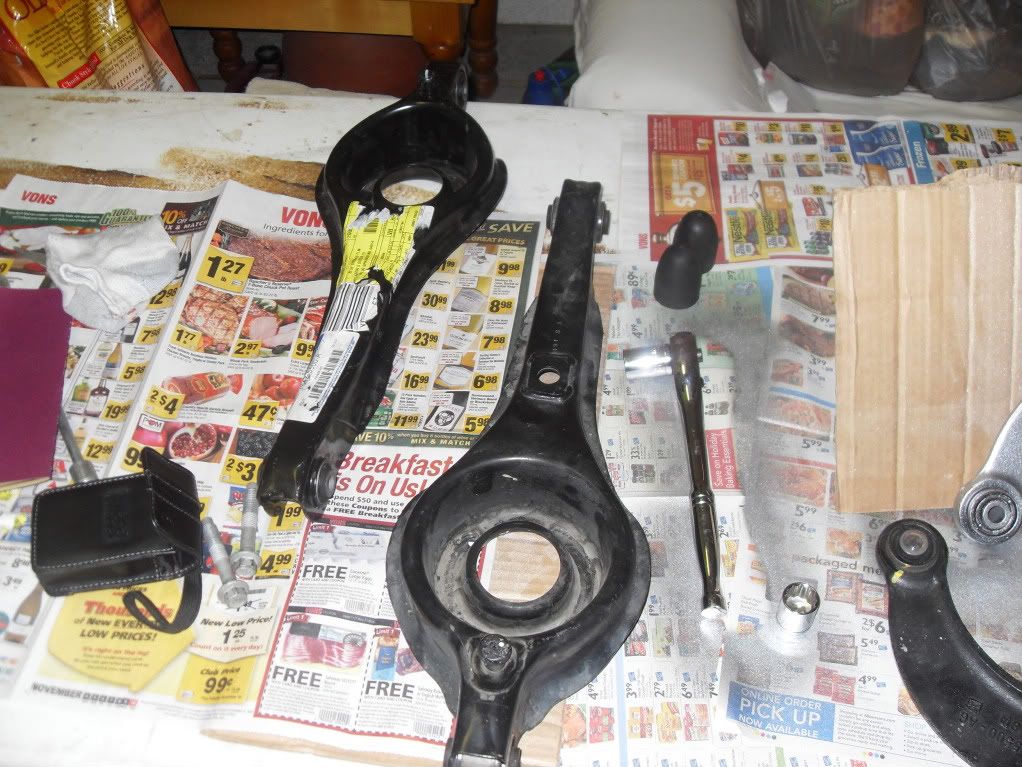

Before

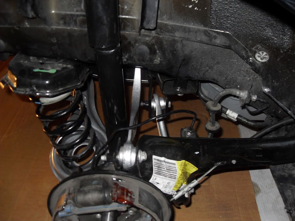

and after

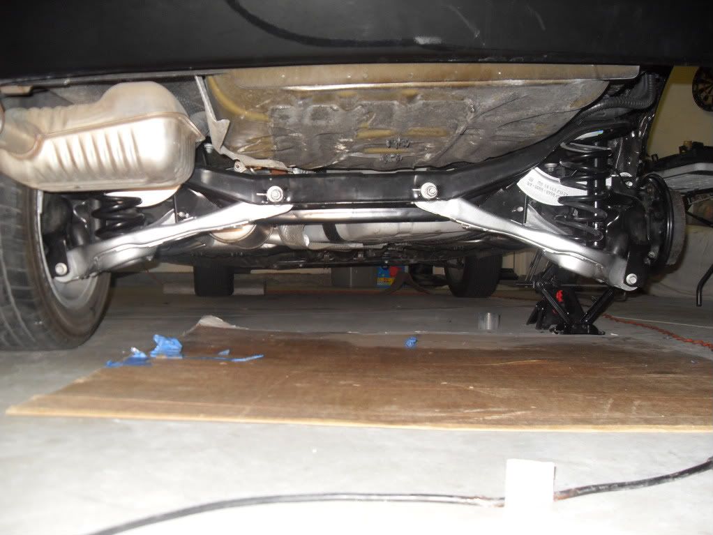

Rear Sway Bar....
Good Job! Looks pretty nice.

question, just wondered why you painted the control arms? they look good just wondered

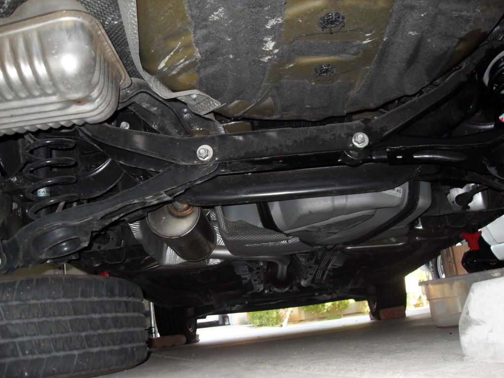

I painted the arms because i think it looks nice, i have seen it done on other cars. you can see it when someone is driving behind you! But i did it because they need to be changed because of the accident
Before
after
I got it aligned just a week ago and i marked the bolts so i could adjust them back to were the where. i hope thats good enough

My tip: Clean the engine bay! It's a lot easier to do it now than in a year or two when all that **** has hardened.
1,266 Posts
Welcome!
Very true...im learning that the hard way :mad:
1,027 Posts
warm the engine,spray it with simple green,let sit and rinse
RECORD PROFITS
5,297 Posts
should i be worried about getting watter in something that shouldnt get wet?
Just try not to spray any wiring.
And also watch the area around the sparkplug wires and coil and whatnot.
Basically clean anything in the area of electrical stuff by hand, and spray away at stuff clear of electrical components.
Don't go nuts with it either way.
