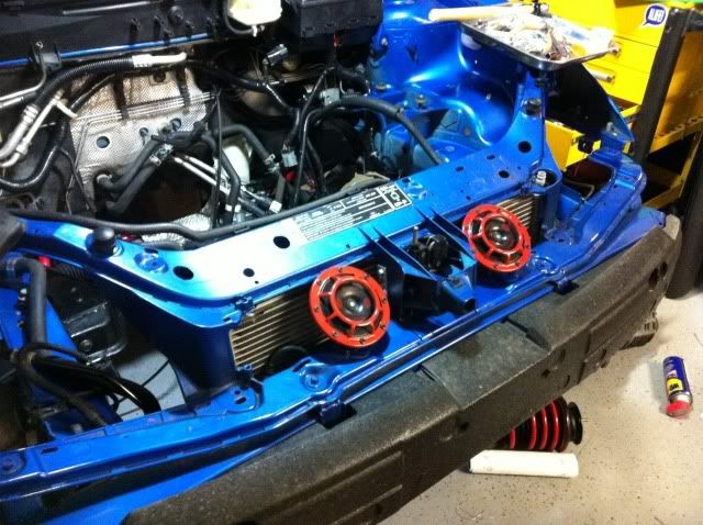

Hella Supertone Horn mounting brackets behind factory grill. Similar to the WRX boys. Keep in mind the car will have a Euro grill on it without turn sigs. Made of 1" aluminum stock and brackets will be powdercoated when done. Not yet complete.
The car will also have a set of Hella Electric Trumpets mounted via SVT twin horn bracket to the lower radiator support. These four horns will be wired on a dedicated relay with direct 8 gauge power from the battery. All wired to the steering wheel horn button.

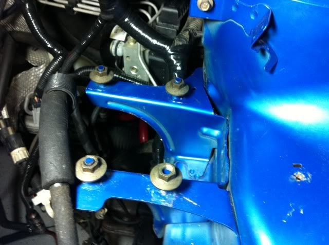

More on the Battery relocation...
Fellow Focus Tuner Jim in Tampa was using marine electrical terminal posts in his engine bay for his battery relocation and really liked the design of them. I decided to go down to my local West Marine and see what they had. I decided on a single piece with two isolated battery posts. One for pos, one for neg. It mounted real swell underneath the fuze box and should be ultra clean when all wired up as I'll be able to keep most of my wiring under the fuze box out of sight.
Completed the wire tuck.
I tucked the main drivers side harness under the frame rail and secured with self tappers, washers, and rubber padded electrical conduit hold downs. Worked out just dandy. I merged, soldered and head shrinked the multiple harness grounds that normally ground to the top of the fender well and made a new ground point under the frame rail. I sanded and prep'd the grounding surface before tightening the ring terminal down. I also tucked the ABS sensor wire under the passenger side frame rail.
I also ran the hood prop cable through the fender well. The cable is free of obstruction and the plastic inner fender cover will protect it even further once its installed. This routing worked great and almost seemed "meant to be".

Also Finished up the Hella SuperTone horn mounting. Fits under the top covers flawlessly. Peep it.
Brackets secured with SS 1/4" hex bolts, washers, and teflon lock nuts. The brackets will be powdercoated before vehicle completion.

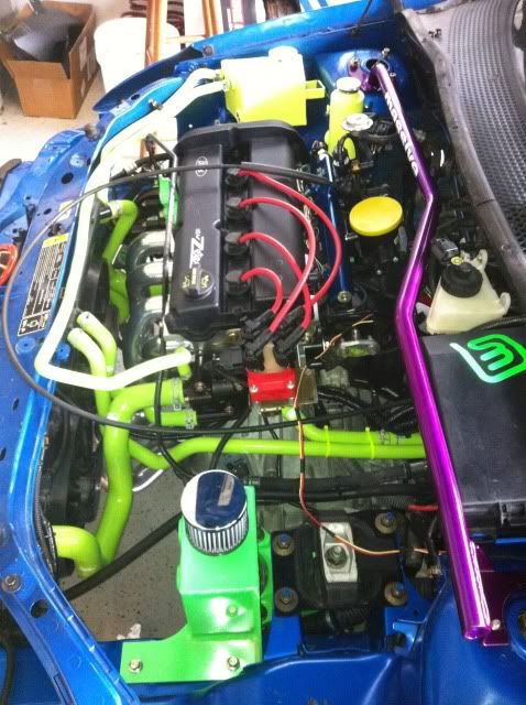

The engine bay is essentially complete, All I've got left to do on this whole car is tidy up the interior, bleed the brakes and add fluids. THEN start the engine for the first time ever!
After waiting over 6 MONTHS TopSpeed sent me a set of Aluminum reservoirs including a catch can that I plumbed in using Aeropquip push lock line and Summit fittings. The VC vents to the catch tank, then drains on the bottom to the CFM crank case vent adaptor. The crank case can still vent to the catch tank as well.
I cut off the plastic barb fitting on the valve cover and opened up the whole about an 1/8" with a dremmel bit, then threaded the hole and inserted a pipe thread to -AN adaptor so I could covert the vent system to push lock line fully.
I got a set of Dominant front sway bar end links from a fellow forum user and threw them on the car as well.
Added some headlamps with yellow 5mil Oracal transparent film applied to them. Sicks sick as hell on the body color. Also put the front and rear bumper back on the car. I'll post some photos of how the HKS exhaust sits in the rear bumper for the next update.
Had a brand new purple anodized FC plug wire cover still on the shelf. Had to use it! Also, picked up a full Samco hose kit from Karl over at Massive in one of the new colors available. Thanks Karl!
