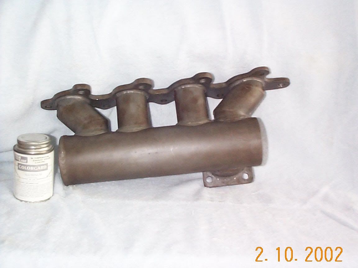

Here's mine it's a log style all stainless. We used cast schedule 40 elbows and tee's so hopefully it wont't ever crack. They are some nice beefy units that had the same bore as the exhaust port so no bottle necking down.

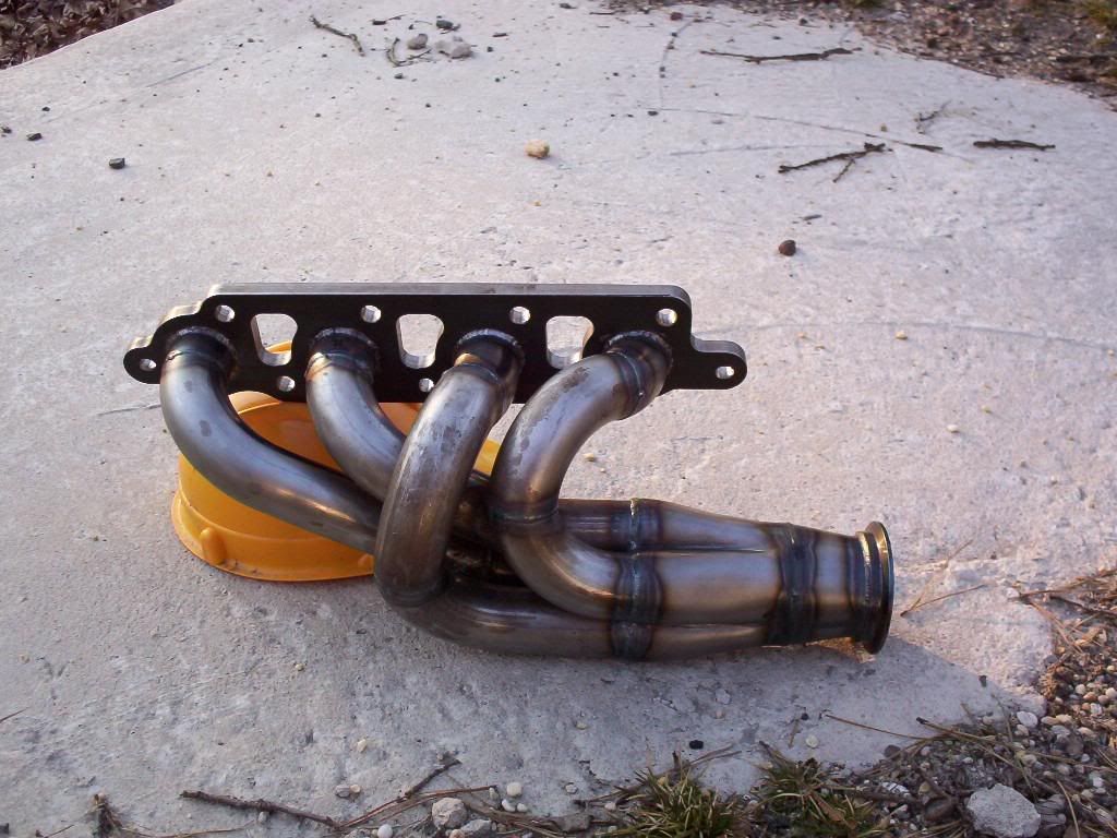

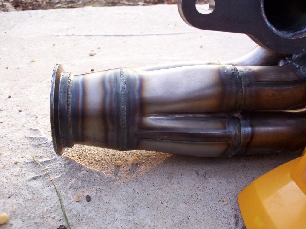

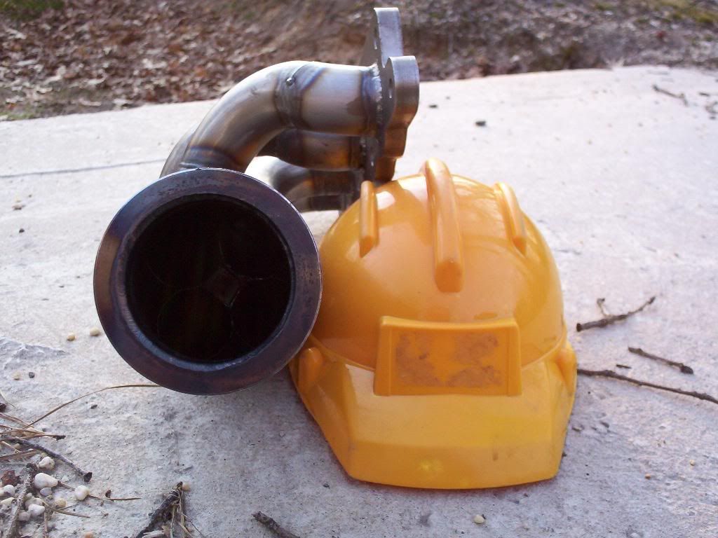

Well this was supposed to be a place to post pics of your manifold but it go combined into another thread and then seperated again. So I gathered up all the pics i could find from recent posts to make it easier to find.
If you can find any others please feel free to add them.:thumbup:

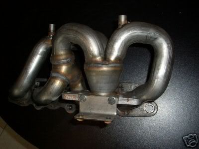

turbo tom manifold that I fabbed up a neck and put a t25 flange on it.
:lol:

hey bur, fyi that manifold will fit an spi but not a zetec unless you drill and tap holes in the head like the engine in the pic has. You can see the old bolt holes exposed. :thumbup:
