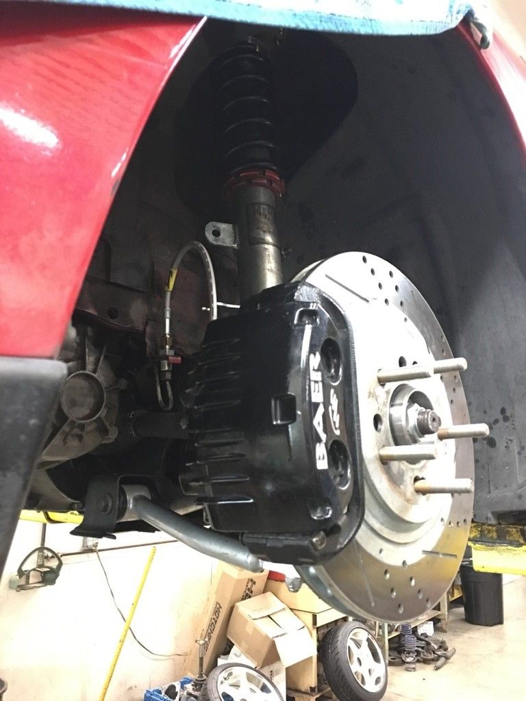

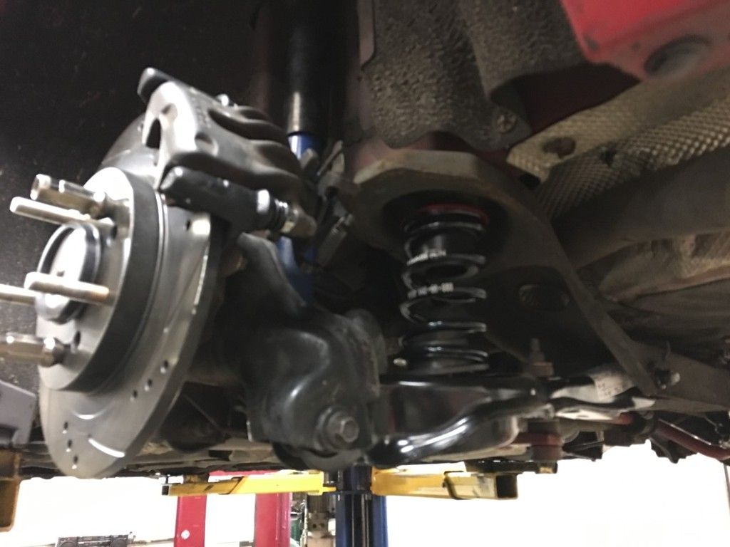

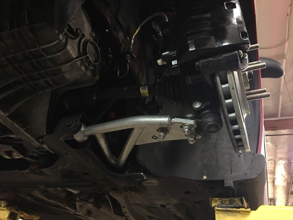

Suspension/Chassis Mods
H & R Coilover fronts with H & R 60mm 514# Linear Race Springs (180mm FL), FSWerks Camber Plates and Aluminum Top Hats
H & R Coilover rears with H & R 60mm 457# Linear Race Springs (140mmFL), Modified TCKline Motorsport 60mm Upper Spring Hats
Custom SuperHub Conversion to 5x114.3 with ARP Bullnose Studs
Dominant Engineering Tubular Front Lower Control Arms
Eibach Front and Rear Swaybars
SPC Rear Camber Arms
Ford Racing Upper Front Stress Bar
FSWerks Lower Front Stress Bar
Focus Central Rear Stress Bar
Baer Big Brake Kit -- Front 330mm (PBR 2-Piston Calipers, 2pc rotors drilled/slotted) redrilled to 5x114.3
SVT Rear Brakes with EBC dimpled/slotted rotors redrilled to 5x114.3
Delrin Steering Rack Bushings
Custom Rear Dust Caps
