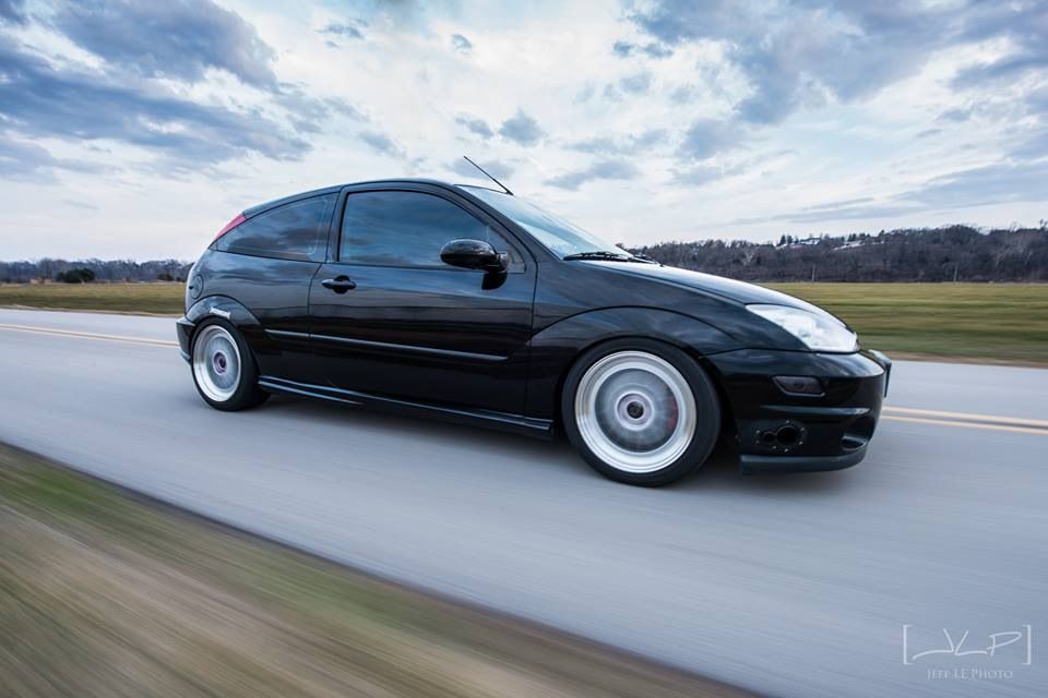

KwickBlackSVT
2002 Ford Focus SVT
-Suspension
ESM 004 17x8 +38 w/ 215/45/17 Dunlop Direzza Z1 Star Specs
Rota Slipstreams 15x7.5 +45 w/ 235/60/15 Mickey Thompson ET streets II
Ground Control coil over sleeves
Eibach pro-kit struts
H&R 24mm front sway bar
Steeda 28.6mm rear sway bar
Energy suspension endlinks f&r
Ford racing front strut tower brace
Focussport rear strut tower brace
Massive rear camber arms
-Appearance
5% rear 35% front window tint
03-04 SVT HID's
Blacked out corner lights and grill
Yellow lamin-x fogs
Very minor wire tuck
-Fuel
2 Walbro 255's
Custom fuel hat
-8 AN nylon braided feed
Steeda fuel rail
Injector Dynamics ID1000's
Aeromotive boost reference regulator
-6 AN nylon braided return
-Long Block
Stock '98 ZX2 block bored .027"
Clevite 77 rod and main bearings
ARP main studs
ARP head studs
ARP rod bolts
Polished stock SVT crank
Eagle rods
CP pistons custom 9.3:1 compression
CP piston rings
OEM Ford head gasket
Ported and polished SVT head
Stock cams
CFM exhaust cam gear
CFM PCV delete plate
Billet oil pump gears
All new seals and gaskets
Powder coated valve cover
Deleted A/C
-Turbo Kit
Garrett GTX3076R with Tial stainless steel .63ar turbine housing
TopSpeed turbo manifold
Tial MVS wastegate
Custom 2.5" hot/3" cold intercooler piping
Tial 'Q' blow off valve
Precision 600hp intercooler with Garrett core
Custom 3" down pipe
Custom wastegate dump pipe
Custom 4" intake pipe with K&N filter
Diablo Sport Mass Air Flow interface adapter
-4 AN nylon braided feed
-10 AN nylon braided return
-6 AN nylon braided coolant lines
CFM 65mm throttle body
TopSpeed custom intake manifold
Moroso catch can w/-10AN nylon braided lines
Greddy Profec-b spec II electronic boost controller
-Transmission
Fidanza aluminum flywheel
ARP flywheel bolts
Spec stage 3 6 puck clutch w/unsprung hub
Torsen T2 limited slip differential
Royal purple synchromax
Ford racing short throw shifter
-Misc
AEM UEGO wideband Air/Fuel gauge
Autometer NV series boost gauge
Autometer NV series electronic fuel pressure gauge
Autometer NV series voltmeter
VF Engineering engine & tranny mount
SCT ProRacer Package
Kenwood KIV-701 head unit
N2MB WOT box
SR Performance

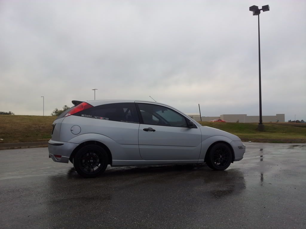

2007 Focus ZX3 (S)
Engine:
2.0L Duratec
stock rods
stock pistons
stock crank
FSWerks stage 2 turbo kit with GT28RS turbo (11psi)
FSWerks 2.5" stealth exhaust
FSWerks tuning by Randy
Cosworth intake manifold (modified by FSWerks)
ported 2.3L head (10% flow increase over stock)
Crower valve springs
Crower custom camshafts
CFM adjustable cam gears
NGK BR6EF (non-projected) spark plugs
VF engine mounts (all 3)
Summit catch can
AMSOIL Dominator 5w20 oil with a WIX filter
Transmission:
MTX-75
Exedy stage 2 clutch
FRPP torsen differential
4.06 final gear
AMSOIL synchromesh trans fluid
Suspension:
H&R coilovers
FSWerks rear stress bar
FSWerks strut bar
FSWerks lower stress bar
Steeda rear sway bar
Wheels and Brakes:
SVT 5-spoke wheels with Continental DWS tires
Summit 5-star 15" wheels with Mickey Thompson 24.5" x 8" slicks
SVT rear disc conversion
Power slot rotors
Hawk HPS brake pads
Exterior:
Stock lol
Interior:
Gutted
Corbeau fixed back seats
RJS 5-point harnesses
Saleen instrument cluster
On to the pics...

I dug out my purchasing agreement to see when I took possession of my car.... FEBRUARY 2, 2007!!!! Cypress Coast Ford in Monterey, Ca. I'm eligible by 2 days, WOOHOO! lol
SR Performance (formerly known as RDY4WAR)
It's a 2007 ZX3 5-speed that I bought new with 16 miles on it. I had zero intentions of modding this car when I bought it. I was looking for a compact daily driver that would be reliable and get great gas mileage. I fell in love with the car pretty quickly and drove it all over the place. I drove it up to Yosemite twice, down to San Diego, all over San Francisco, and pretty much anywhere my wallet could take me. In 2008, I drove the car from California to Texas and then 6 months later from Texas to Maryland on PCS moves with the military. The mod bug hit me then but instead of doing bolt-ons, I decided to go straight turbo. I installed the FSWerks stage 2 turbo kit in December 2008 with just 19k miles on the car and it's been a blast ever since.
I started out with the FSW turbo kit, Exedy stage 2 clutch, and FSW 2.25" exhaust for the first few years. The car dyno'd at 230whp/215wtq at 11psi with the stock intake manifold, stock head, stock cams, and stock transmission. In 2011 I started to mod the car more. I replaced the transmission with a built one with a FRPP torsen differential and 4.06 final gear. I also replaced the 2.25" exhaust with the newer 2.5" stealth exhaust from FSWerks, and I replaced the stock intake manifold with a modified Cosworth unit. That following winter, I replaced the stock head with a ported head with upgraded valve springs and Crane stage 1 cams. The car dyno'd at 285whp/230wtq with this setup. The only major addition in 2012 was the meth injection. In 2013, I added the custom cam setup that I'm having the tune dialed in on currently.
The turbo kit has been on the car for 5 years of the 7 years I've owned it. It has 90,800 miles on it with roughly 71,000 of those miles with the turbo. This car is not driven lightly. It has seen a lot of drag racing, as well as autocross. It's made several long distance drives halfway across the country. The car fits my personality of function over form. It's not the most stylish car out there but it drives great and makes great power. I was the first (that I'm aware of) to go 12.xx in the 1/4 mile with a stock motor 2.0L duratec with the stock intake manifold. In October 2010, I ran the car through the 1/4 mile at 12.94 @ 105mph with a 1.91 60ft (8.29 @ 86mph through the 1/8th mile). I backed that time up the following weekend at the World Cup Finals with a 12.93 @ 105mph pass in qualifying. This was done at the 230/215 power level with the stock transmission.
My future plans for the car are to build the motor, and upgrade the turbo shooting for 400-420whp.
2007 Focus ZX3 (S)
Engine:
2.0L Duratec
stock rods
stock pistons
stock crank
Summit catch can
Transmission:
MTX-75
4.06 final gear
Suspension:
H&R coilovers
FSWerks strut bar
Wheels and Brakes:
Power slot rotors
Hawk HPS brake pads
Exterior:
Stock lol
Interior:
Gutted
On to the pics...
