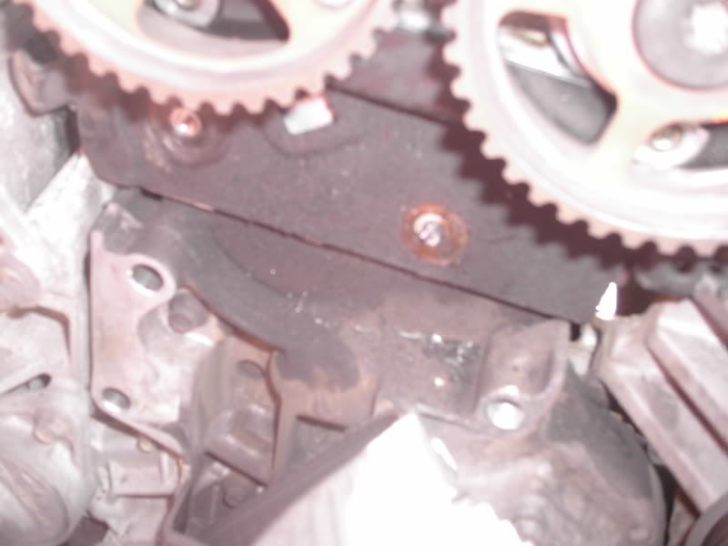

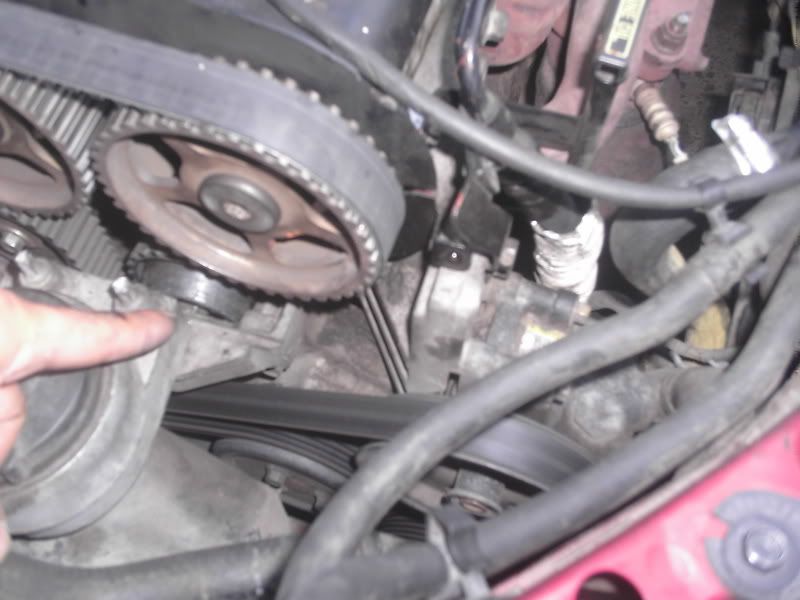

Well If you look at my other thread here in team tech you will see what happened to my car
2 weeks ago I went back to the stock head
so I could sell it:rolleyes:
low and behold this problem arised
No I am gonna hev to take the stock head off and have a buddy of mine drill the bolt out and have it heli coiled so it has new threads in it
it was cross threaded:thumbdown
just my ****ing luck
here are some pics
If anyone, I mean anyone has been able to drill that sucker out without takeing the head off, please by all means let me know how you did it:thumbup:
John
No room at all
even with the engine jacked up all it can be
trust me, we tried
I have to take the head off, sux, but in order to have it running again, I'm gonna have to do it

if it werent cross threaded, Id say you could turn it out with LH drill bit and a pick. :(
90* air drill usually fits but maybe not. :dunno:
I busted a shouldered T-belt tensioner bolt off in the block of a Volvo once. Alldata had the wrong torque spec. :rant:
just so you know i had the same thing happen to me and all i did was jack it up and got a tap and die set it worked for me. good luck
