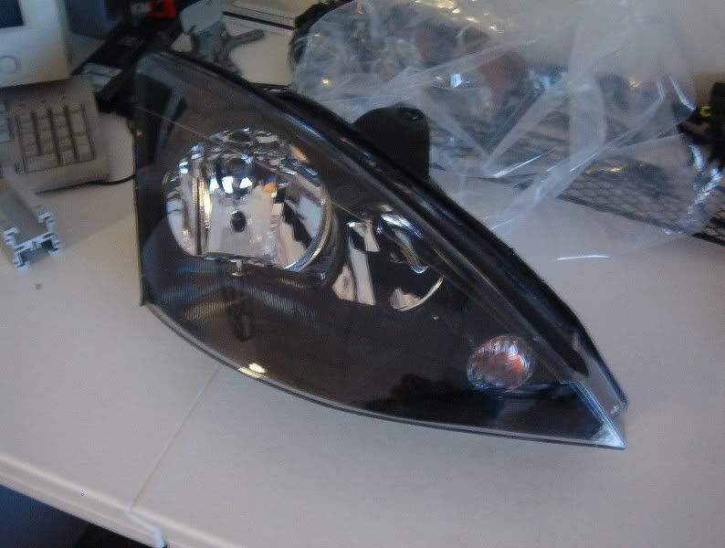

Chrome plating is nice and even, no pit spots. Black is gloss black.
Front view, clear indicator. (little fuzzy)

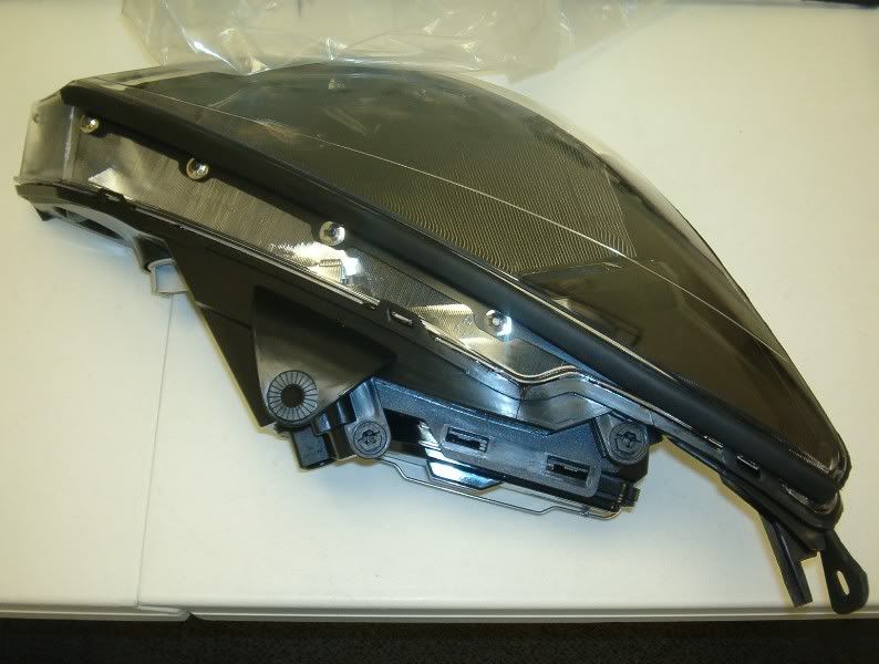

Top view. Uses stock mounting points and adjustment locations. Has stock rubber trim.

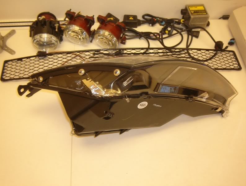

Side bottom view. You can see it has metal clips holding the lens to the body and the glue is OEM like so they can be openned up and repainted body color.

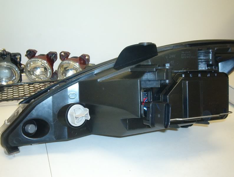

Back view. The cover in the back is secured with the wire clip and is well gasketed on the inside lip. Gray round thing on the far left corner is a vent, to the right is the turn signal.

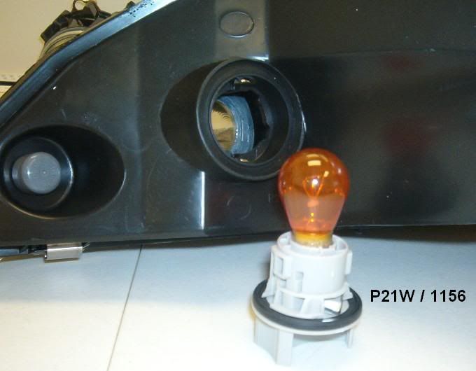

Close up of the turn signal and holder. Its a 1156 bulb and yes I'm getting the chrome when off bulbs. You can see in the hole the clear indicator lens.

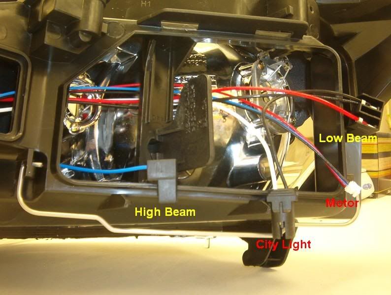

Inside view. Wiring loos sufficient and OEM thicknesses. The city light goes under the lowbeam on the right. The black paddle shaped thing in the middle (above the highbeam connector) can be removed by turning clockwise and replaced with the headlight height adjustment motor from a european Focus. The connector for the motor is in the picture and will be left hanging on my car.(no motors)
Highbeam.....H1
Lowbeam.....H7
Citylight........194
Turnsignal.....1156

While I also cross-referenced the P21W to an 1156, it is not exactly correct, as the bayonnet tabs are not exactly opposite each other. Though I did manage to fit an 1156 in for the time being, I now have some 7507's that should be correct.
