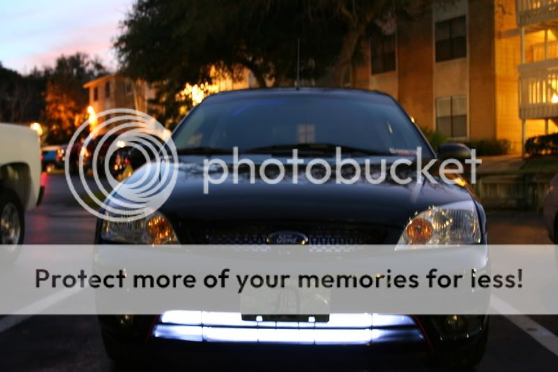

I went ahead and threw a 3' waterproof LED strip from Oznium in the lower part of my grille so I could light it up while I am driving at night. I think it looks great and I have never seen anyone else do this. :thumbup: Let me know what you think.

I'd like to see it with the parking lights or headlights on...I like the concept and I think it's actually kinda funny/cool that the lower grill posts will make it look like an angry set of teeth. In terms of legality you should be fine when you turn on the headlights.

I'll take some more pics with the lights on tonight when I get home from work.

It was pretty easy. If you feel on the lower part of your front facia, there is a little lip. I just dropped the LEDs through the front right of the engine bay to the ground and then grabbed them, pulled it all onto the facia to check length and stuck them (with provided 3M tape) right under that lip so the light would be cast backwards at the radiator. A 3' strip will be about 6 inches too long. You could probably get away with a 2' section (and save yourself $13). If you need any more information, i will be happy to help (although it was on an '07). It was really fun! :thumbup:

Oh, almost forgot. If you look at your pedals from the drivers side, behind them on the firewall there should be a little oval of plastic that you can drill through and it will take you right into the engine bay so you can run the wires from outside to your fuse box (and switch). It may be covered with a little flap of carpet. Root around and you should find it.
