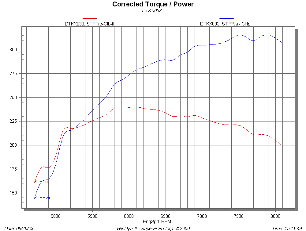

Circle Performance, www.circleperformance.com in Massachusetts has posted dyno test results conducted in June. A Ford Ranger version Duratec 2.3 fitted with mechanical fuel injection, belt-drive higher lift cams, a dry sump oil system, forged high compression pistons (14 1/2 to 1), forged rods, a steel crankshaft and burning pure methanol alcohol is making about 320 peak h.p. at 7500 rpm.
At 6100 rpm the engine makes about 280 h.p at 240 ft/lbs torque. This engine is naturally aspirated...no boost!!
I understand that Circle has not performed any headwork. No porting and polish and still using stock valves and springs. Their engines are for sale.
See dyno test at: http://www.circleperformance.com/images/image_gbl/DTKX033.BMP

and burning pure methanol alcohol...
ya know. i would like 320 hp in my focus right now and im not denying the work they did (320 outta that engine is fresh as hell) but when will we get some things that would be more street applicapable. cuz uhh, im not paying out the arse for methanol street driving, would you?
Umm...a buck and a half to two bucks a gallon for methanol really gonna set you back?
You're right. Methanol is not the best fuel for a street driver. To many problems. My intent is to show how Circle and other builders have to do very little to this Duratec engine to achieve great results. Most midget race cars are not allowed to use gasoline and must use "antique" mechanical fuel injectors. However, other components, like higher compression forged pistons, connecting rods, steel crankshaft and a few other improvements for reliability can be used in many applications...street, strip, road-racing or circle-track.
Just wait until the headwork is complete. Simulated dyno runs on the computer are estimating 400 h.p. at 9500 rpm.

does suck though that some1 couldnt do more with the zetec NA. i mean 2 cars in race trim just breakin 210whp or whateva...sounds quite weak, figure some1 would have figure out 225 if not 240, 250.

Those are just the "test" venturis. Kind of ugly but they work for R & D purposes. Same for the stock coils on top of the cam cover. As for rear-drive or a transaxle conversion, Altech Precision, www.quad4rods.com makes bellhousings and adapters for the Duratec, Zetec and Quad 4 GM engines. John also has conversion pieces to use a carburetor and a few choices for ignition that don't require the use of a computer.
I provided the basic long block engine shown in the old photo (taken in June of 2002). $800.dollars plus trucking from Ford-Detroit gets you a stock long block Duratec. $1000.dollars buys a new in-crate Zetec. A portion of each sale to a FJ member goes back to the FocalJet website.

Actually the USAC Focus Midgets and the SCCA Formula Zetec road racers are required to use a stock sealed 2.0 Zetec engine. The only improvement to the internals is stronger connecting rod fasteners. Both vehicles are very light...900 pounds, so a 160-180 h.p. Zetec is adequate.
One company, S.C.R.E.A.M. is the only supplier of converted USAC Focus midget engines. A Zetec is fitted with mechanical fuel injectors, a dry sump oil system and some sort of computerless ignition. Quicksilver Engine in Frederick, Maryland provides the Zetecs for the SCCA Formula Zetec road racers. They do use electronic fuel injection ( multple venturi ), a dry sump oil system and a computer for engine management.
Quicksilver is also building the Duratec 2.3 engines for the new entry-level "Formula SCCA" class. A chassis that can be fitted with a full body or an open-wheel formula body and is powered by a 2.3 Duratec. See:

i'd like to eventually see dyno results taht i can relate to. like 100, 100 or better yet 93 octane gas. that's when i can see the usefulness of this engine. even tho i'm not doubting you
have you people compared t to the Zetec? just going ahead and doing all that work and not having anything to compare it to is like saying that you have a computer that is the best even tho there is no other on on the market...
I'd like to eventually see dyno results that I can relate to. Like 100, 100 or better yet 93 octane gas. That's when I can see the usefulness of this engine. Even tho I'm not doubting you.
Have you people compared it to the Zetec? Just going ahead and doing all that work and not having anything to compare it to is like saying that you have a computer that is the best even tho there is no other on on the market...
That's a fair question. Here are 2 year old dyno results from the 2.0 liter version Duratec fitted into road racing cars and using pump gasoline. The intake and exhaust have been replaced but the engine's internals remain stock. The engine management system is limiting the output to about 190 h.p. as it would overpower the driveline and ability of the chassis!

I believe there are also dyno results on two Duratec-related websites, http://www.duratecperformance.com and http://www.duratecperformance.co.uk
And yes, My company has compared various engines...OEM and dedicated race engines and the cost to modify them. Currently, the Duratec is the best and cheapest investment to produce the most power per pound of engine. The Duratec weighs about 200 pounds and a Zetec about 245. The Zetec will be phased out of production to be replaced by the Duratec. The Duratec is based on a proven Cosworth Formula 1 race design. The Zetec...well??

so basically your're saying that the duratec can't or shouldn't go past 190WHP for what reason? overpower the driveline and chassis? well then how does the 320 duratec do it? is that stuff fixed or something?
No. The engine he was talking about is being used in a spec race series in Britain. The power limit was intentionally put into whatever ECU they are running because their spec car couldn't practically handle more than that. If you're dropping one in a previously-Zetec'ed Focus, you won't have that same issue.
