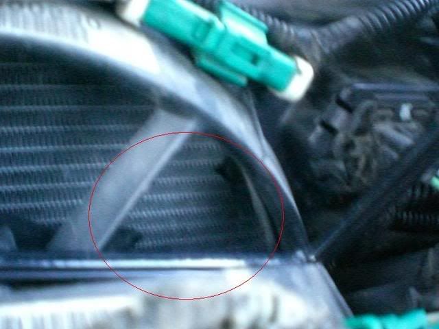

Story - Kicked up some rocks, put a hole in my radiator, and broke a fan blade off my fan.

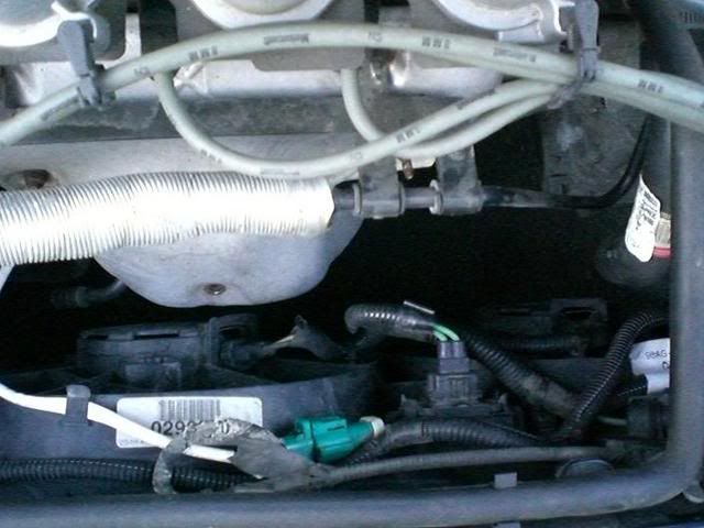

I believe it's the LEFT SIDE fan - the highspeed fan that kicks on when engine is hot - see picture:
Here you can clearly see a fan blade missing:
QUESTION: is the LEFT SIDE fan the highspeed fan? My car vibrates roughly when that fan kicks on. Can I just replace the fan blade or do I have to replace the motor as well???????

if you put a hole in teh radiator, your gonna wanna replace that too
that vibration is probably coming from the unbalanced fan assembly spinning.
IIC, the fan blade is held on by a clip that needs a special tool to get off/put on. It'd probably be easier just replace them together.
