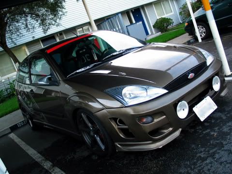

My first car owned under my name
2000 kona focus. bought used in San Francisco 2003.
2003
