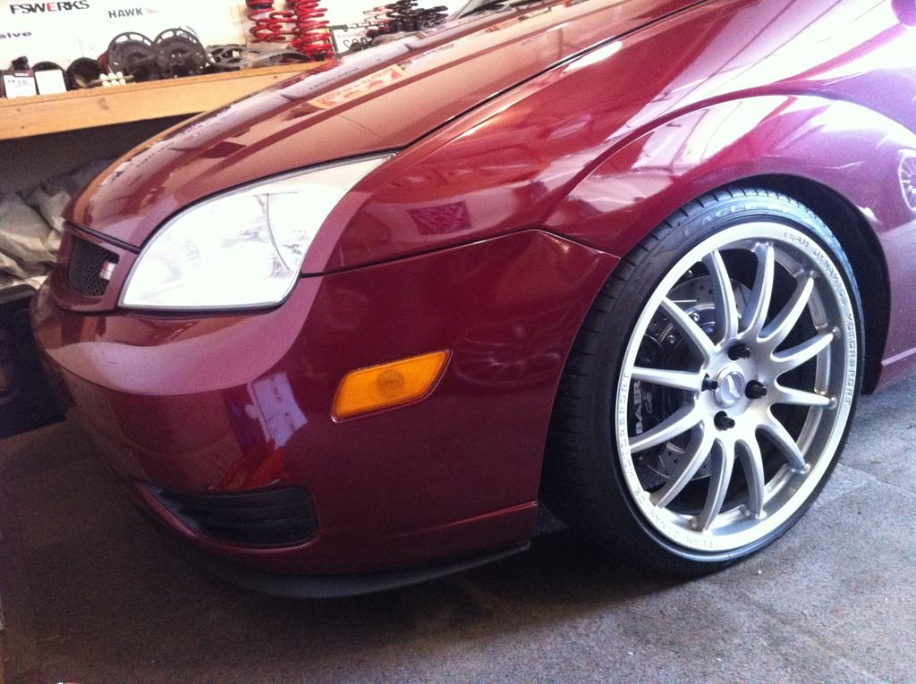

Wheel Brand/model/Spec(size/width/offset):
Team Dynamics PR1.2 in 18 x 8 et40 Front
Team Dynamics PR1.2 in 18 x 9 et35 Rear
Tire Brand/model/Spec:
Goodyear Eagle F1 Asymmetricos
Front 215/35 Rear 225/40
Suspension parts:
'00-'04 H & R Coilovers with Massive Omni Kit
H & R Coilover fronts with H & R 60mm 514# Linear Race Springs (180mm FL), FSWerks Camber Plates and Aluminum Top Hats
H & R Coilover rears with H & R 60mm 457# Linear Race Springs (140mmFL), Modified TCKline Motorsport 60mm Upper Spring Hats
H & R Front Swaybar on softer setting + Moog Front Endlinks
SPC Rear Camber Arms
Steeda Rear Swaybar
FSWerks Upper Front Stress Bar
FSWerks Lower Front Stress Bar
FSWerks Rear Stress Bar
Baer Big Brake Kit -- Front 330mm (PBR 2-Piston Calipers, 2pc rotors drilled/slotted)
Baer Big Brake Kit -- Rear 305mm (PBR Calipers, 1pc rotors drilled/slotted)
Custom Rear Dust Caps
Drop (fender heights are acceptable):
Front fenders at 23 3/4"
Rear fenders at 25"
Alignment spec:
Camber:
FL: -1.9° FR: -1.9°
RL: -.8° RR: -1.6°
Toe:
FL: 1/32" FR: 1/32"
RL: 1/16" RR: 1/32"

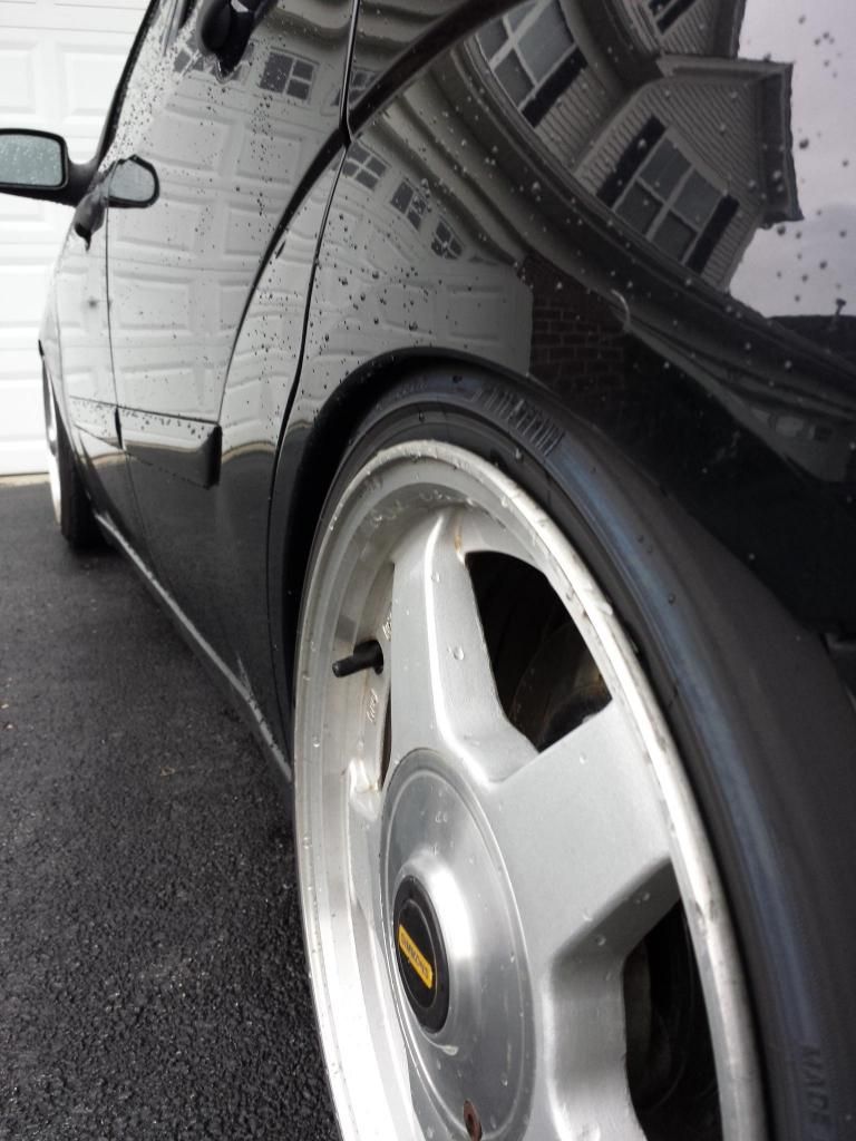

ESM 009R wheels, 16x8 front and 16x9 rear, et 30 all around
Federal evo 595 195/40r16 fronts, kumho ecsta 205/40r16 rear
Suspension parts:
KSPORT coilovers, ebay camber arms, dominant toe arms
Drop(fender heights are acceptable) and alignment spec (camber and TOE!):
Il get the measurements tonight, but i only have about 3/4 inch left to lower the front, and the rears have the adjusters removed
Camber---
Fronts are natural, no exact measurements
RL: -3.6° RR: -3.4°
Edited with bottom pic with center caps
