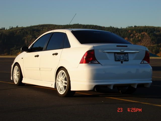

I'm pretty sure the tails are only differently shaped where they line up with the trunk lid with the quarter panel line being the same. I remember reading a thread on FF a while ago where someone did the conversion and they just swapped parts. The only snag they ran into was the trunk lock because they're in such different spots IIRC. It's been soooo long since I've looked at anything but the for sale forum over there though :lol:
http://i46.photobucket.com/albums/f125/1badfoci/willowgrove040.jpg
http://i8.photobucket.com/albums/a10/ZenRanger94/Kens Car/DSCF0097.jpg
Not the best angles, I know.... Who wants to try it and find out for sure? lol
All you need to do the 05-07 SAP rear on a 00-04 is the tails, trunk lid, and bumper. The quarters are the same. What is different though, is the location of the key hole on the two trunk lids. Not exactly sure how to go about getting your 00-04 key to work with a new 05-07 trunk lid / lock mechanism.
